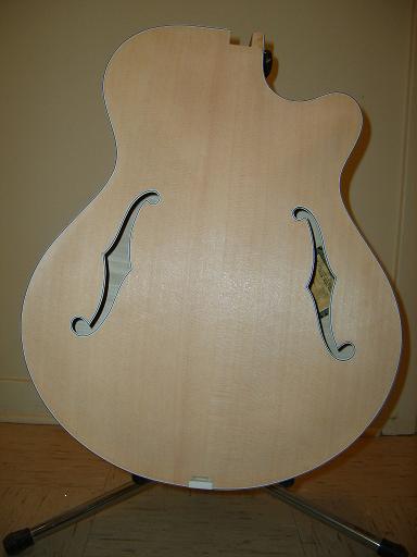

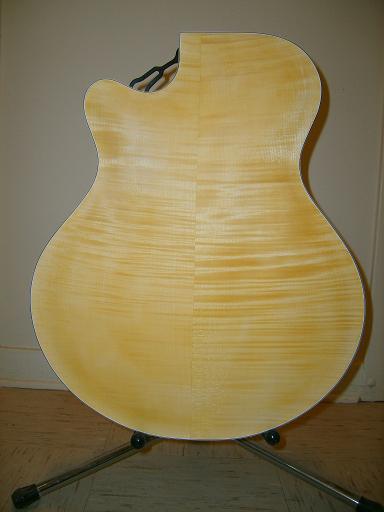

Bruce Dickey requested that I post progress pics of my archtop, so here it goes.
B&S: euro maple
top: Sitka
neck: Bigleaf Maple
FB: Ebony
Inlay: Gold MOP, Black MOP, River pearl, African Blackwood
I built it mostly from the benedetto book. The major differences being, a bolt on neck and truss rod adjustment through the head stock using a long ballend allen wrench.
Right now it is just stained, I will try to finish it in the next couple of days.
Matt

Beautiful...the binding on the f-holes really catches my eye for some
reason - it isn't obtrusive, it just looks really nice. I also like the inlay on
the back of the neck.

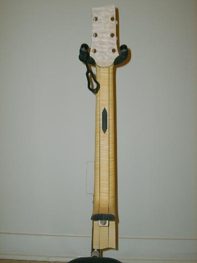

Are you going to access the neck bolt via the endpin hole? (allen wrench with extension)

That's shaping up very nicely, Matt! So what's the story behind that back-of-neck inlay--a tragic rasping accident? Looks cool, BTW.

Matt, looks great so far! Can't wait to see it with some finish on, man that will really pop the grain on that back. I was impressed with your work when we met at Bruce's, now I'm even more impressed! Sweet!

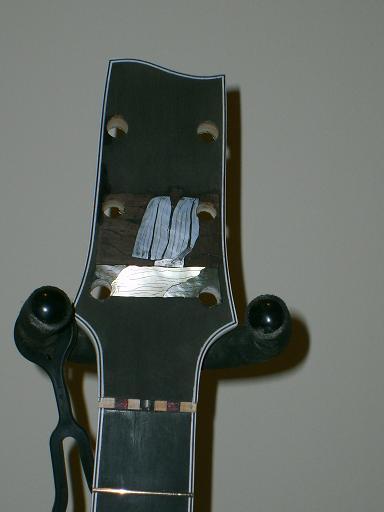

The tuner holes look a little close to the edge of the headstock. Will the tuning machines hang over the edge?
PostPosted: Wed Jan 03, 2007 2:40 am
Posts: 300
Thanks for the compliments everyone.
As far as the bolt-on neck it is pretty much a standard mortise and tenon joint with threaded inserts in the end. To access the bolts I use a 24"long x 1/4" drive extension through the endpin hole. It was a little tricky to maneuver at first but now it is a breeze.
Anthony- this is guitar #5 but my first archtop
Carlton- The neck inlay was totally intentional .
Actually I was using a friend's router table to route the truss rod slot, when the bit climbed out of the collet and went through the neck.
